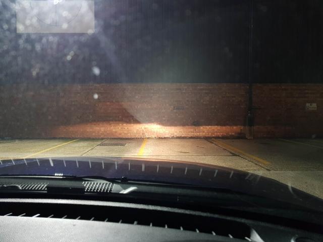

Not the best photo, but you can see there is less light on the left.

Hmm, judging by the hot spot and cold spots it looks like possibly both bulbs are in the wrong place relative to their reflectors or lenses.  Maybe their bulb holders have been moved relative to the shell by brute force at some time, maybe to get by with the wrong bulb.
The only way to check it properly is to park on level ground, square-on ideally three metres in front of a white wall, and look at the beam pattern, first for the high beam and then for the dip beam. (block the light from the unwanted bulbs)
If the non-adjustable high beam is off axis either left, right, up, or down, then there is a mechanical problem with the shell relative to the body or the bulb in the shell.
If the dip beam is off then as above, and also the up/down motor linkage and/or the default setting for the aiming adjustment (motor reference) could have a problem.
The centres of the left and right beams should be the same distance apart on the wall as their headlights. The height of the top of the dip beam to the right of the kink should be 30mm (at 3metres) below the centre of the headlamp, with cabin adjustment knob midway and one person in the car.

First image is from about 3m away

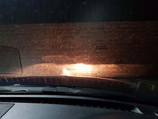

This is about 7-9m away
 Didn't get chance to take an exact measurement.

That looks about right, perhaps the left beam is a fraction higher than the right.  Don't make any adjustments to either one until you can be sure of the measurements.
If you were in any doubt it can be useful to ask an assistant to move a card (A4 maybe) to cover first one lamp then the other, just to make sure which beam is producing which pattern.  However with the two different distances and the spacing remaining the same the L-R aim looks OK.
EDIT.  Hmm, looking at it again I'd say the right beam is spot on with excellent cut-off, but the hot spot and poorer shape on the left beam might be because the bulb could be misaligned with the projector lens, perhaps the lens has had a knock or has developed a crack.
