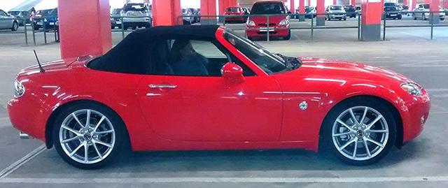

It might be useful posting a side on view picture of your car to give us an idea of the height.
Bilsteins are fitted to the sport model, those fitted with lowering springs (well on my car) did cause the suspension to bottom out occasionally on certain undulating roads.
Also on some rough road surfaces I got an annoying rattle/thudding from the rear end. I put this down to the bump stops or as reported in other threads I've read a loose cup on the shock for want of a better term.
I've since had MeisterR's fitted and all is well, a smooth noise less ride, also changed all drop links as one had broken away on the front.

That would be helpful, please. Measuring from the wheel centre to the arch mine are 380mm front, 345mm rear. The tyre depot's computer said the minimum height at the rear is 355mm, but it was working from specs for "MX5 2004- 9" with no mention of "sport" or "roadster" so the car may actually be correct! What I really need is someone else with the same model to measure theirs for me . . . .

My 2008 NC PRHT Niseko has standard suspension and wheels.  The height from wheel centre to wheel arch on each of the four is 375mm.  AFAIR 380mm is standard, and mine has had ten years to settle.
It seems as if yours might have had lowered springs fitted at some time, or they have a broken coil, but now you have standard at the front and lowered at the back.
The all too common 'twisted bush problem' (rushed mechanic) is most unlikely to lift the front of the car by 20-30mm.
I don't know which should be correct for your particular car, and the rears can be slightly different depending if you have soft top or PRHT, but your current set up is definitely wrong. (You don't have a few bags of cement on the boot?)
Get the car up on a lift again and check what colour the dots on the springs are, to see what you actually have, and check for the ends having broken, usually the end of the last turn - a bodger could have just taken the bits out and left the rest of the spring in place.
With positive info on what is actually there in the car, someone here will be able to point you in the right direction.

Mine measures 330mm front and rear but I have MeisterR's, fitted and set up by that very good chap in Sheffield.
When I had Bilsteins with lowering springs they measured approx 340mm F and 335mm R
With the Bilsteins and lowering springs fitted

To answer questions from several responses:
Trying to improve handling and cure the rattle I had new tyres and drop links fitted. Then the car went on the alignment machine, and I noticed the ride height issue for the first time - that's the only connection between ride height and rattle!
The car has a "standard" powered folding hard top roof - is this a "PRHT"?
It sounds like the front(380) is correct and the back(345) too low - this ties in with "the machine" rejecting the rear height as outside normal parameters - it accepted 380 and 355 . . . .
I'm pretty sure it hasn't been modified - all the suspension parts were equally rusted into place! Hopefully, no-one would lower just the back??
Sadly, there isn't a bag of cement in the boot!
I couldn't see any damage on the springs, and both sides are exactly the same height - wouldn't it be odd if both springs broke, and dropped by the same amount? I'll go back to the garage and ask them to have another look for damage or identifying marks on the springs.
